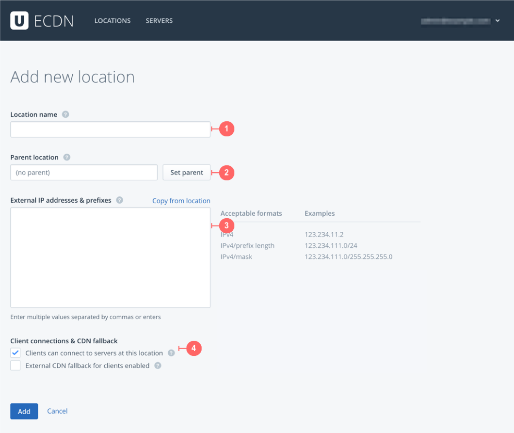

1. Define locations in web portal
Access the ECDN Management Portal using your login credentials.
Your starting page is the list of your locations that will be empty upon your first login.
Click the Add new location button, it will open the form where you can define the new location.
  1. Enter a unique name for the location.
  2. Set parent (if this is a child location).
  3. Enter the external IP addresses/address ranges you want to enable ECDN traffic for.
  4. Set your preference for client connections. If you enable client connections, you can also set preference for external CDN fallback.*
  5. Click the Add button to save your settings and create the location.
*External CDN Fallback
  • If enabled, clients can request content from external CDNs if the pre-defined ECDN edges are unavailable or fail to deliver content.
  • If disabled, internal clients will use ECDN servers only for downloading the video streams.
Note: Too many clients connecting to external sources can cause overload on the corporate Internet connection. In case all the ECDN servers become unavailable and the external CDN fallback is disabled, the playback will be interrupted until an ECDN server becomes available and operational again.
